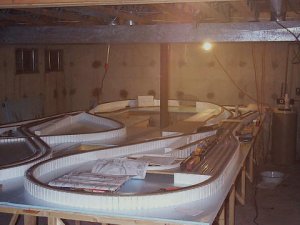

Mike;
Do you mean where the two tracks cross the one? What you really have there is a reverse loop going each way. There is a double cross over on up to the left that you can't see. If the train is on the left hand track it loops back around and crosses back over on the single track. If it is on the right hand track it comes around and can come back down onto the left track or can go straight ahead down a spur that runs the entire length of the layout, about 21'. The spur is dead end now as I can't seem to make up my weak mind what I want to put down there; coal tipple, grain elevator, small turntable?????????
Bob
I'll be more than happy to post more pictures when there is progress to show off. Yesterday I spent some time taking out all of the wiring except the drop leads in preparation for installing DCC before I go any farther. Let's see, after I get that finished I'll need to stop for a spell and run a few trains using my DCC and then back to "building." :D :D
