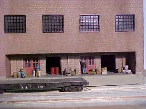

Here's a look at some of the progress I've made on the Leigh Foods plant.
I wanted a busy loading dock, but didn't have room to build one on the side of the building, so after some brainstorming, I hit upon the idea of cutting a hole in the side of the building, & building the dock INSIDE the structure...This is pretty much all I have completed so far.

Geez Charlie,this style of loading dock seems to be catching on.:D I'm liking it tooooooooooooooo.:D

I started by spraying the building flat white. Then I brushed on some slightly thinned Polly Scale Boxcar Red. After that dried, I painted the foundation Polly Scale Concrete. The last step was to cover everything with a very thin wash of Polly Scale Aged White, & then wipe it off with a rag.
I didn't notice until I posted the picture that there are some spatters of black paint that I need to go back & touch up.:o
I worked on the structure til late last night...it's coming along...details, details, details! I'll try to get a picture of the whole thing up soon.
Hi Bob!
Those spatters on the foundation don't really look like spills...(not in 1/160 scale, anyway :D )...but you just gave me a great idea! Thanks!
