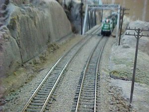

On two of my modules that I wanted to not have this short section of track showing between them, I took the rails right to the edge of the module and connected them with a small length of brass wire that slid into a piece of brass tubing that was soldered to the rail on each module. This held the track in allignment as well as provided a path for electricity to travel if required. I have attached a picture that will hopefully show this connection. (It happens to be on an HO module, but it should work for N as well.)
One of the problems with this arrangement is that the track can be damaged VERY easily when transporting the modules, so consider this before building your modules this way. :mad: You may also notice that the tracks between these modules do not cross the gap perpendicular to the edge of the module. I wanted to get away from the straight line look.:D

Upguy - Thanks for the info. From the picture (which looks great, BTW), it looks like the break is on a curve - is that right? Is it on a grade?

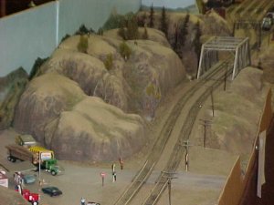

Here is another angle of the two modules. There is a small white speck on the track where the modules are joined. You can see better the degree of curvature in the track. Keep in mind we are discussing N-scale track configurations, but looking at HO modules.:eek:

upguy: That module looks great. You did a good job concealing the joint. The line up the side of the hill could easily be a fault line...
