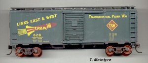

These are my latest projects that I finished. They are all bluebox kits that I assembled and weathered.
Here is the TP&W boxcar
List of Materials
Bev-Bel/Athearn 40’ Boxcar (247-3)
Kadee #5 couplers
Weathering:
Drybrushing: Folk Art Charcoal Gray (613)
Wash: Folk Art Charcoal Gray (613) 2 parts; Folk Art Licorice (938) 1 part; thinned 5:1 with blue windshield washer fluid
Sealer: Testors Dullcoat
Trucks:
Paint: Folk Art Charcoal Gray (613)
Drybrush: Americana Burnt Sienna
Wheels:
Paint: Americana Burnt Sienna mixed with Folk Art Bright Peach (682) 1:2
Sealer: Plaid Clear Acrylic Sealer-Matte (CS200306)

Excellent work Tom :cool:
Shamus
Thanks, Tom for those weathered cars. I have an Athearn Lehigh Valley 50 ft. boxcar kit. One question, don't the workers wipe off some of the numbers so they can be read-- and if so, which numbers? Also, is that rectangle on your Lehigh Valley car (and mine too) a bar code?

Thanks everyone!

I'm not familiar with the TP&W but I like that rocket logo! I'm especially fond of your subtle dusting of the Dixie gon. Nice work as always Tom! Hmmmm, how long before they're seen rolling by that old water tower? :thumb:

If I remember correctly TP&W stands for the Toledo Peoria & Western. (If I am wrong someone please help:oops: ) The line is located in the upper Midwest. I don’t know a whole lot about it. I bought the boxcar when I was in a buying frenzy and not paying attention to what I was getting. About two years ago I went through my rolling stock and narrowed my focus to the lines that I am currently concentrating on. As a result I sold the TP&W boxcar pictured.
