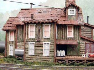

Here it is all weathered and ready to be placed on my NEW Badger Creek in the near future.

I use graphite chaulks to weather almost everything, then a spray of dullcote to finish it off.

I scratchbuilt the structure the same way as my article on scratchbuilding which is in the Academy/archive section here in the gauge. I always use stripwood which is individually placed and glued one at a time onto the Card (Kellogg’s Cornflakes packet)
Here's a photo of another one of my structures up close to show the stripwood etc, by the way, the roof shingles where all done one at a time. -- (100's of them)
shamus

Bob, The fish structure to me two weeks to make at around 3 hours per day.(Being 65 I have all the time in the world) The cost around $7 - $10 or less per structure depending on how much stripwood is needed. I have around 20 plus scratchbuilt structures on Badger Creek with a further new one I have just started. Sometimes I just either sell or trash an old structure and replace it with a new one. Anyway, I am never at a loss for anything to do.
