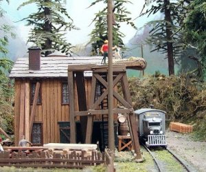

You could make your own fences out of stripwood for N-scale or H0, I use 1/8" by 1/64" wood cut down the middle to make mine, here's a photo (Bottom left is the fence.

Ok, i have it now. I tried the cigarette box idea and i didn't like the way it was turning out. So i tried the 1/8" square wood idea split down the middle (thanks shamus) and tied together on the side not seen, it looks very good and convincing, but very time consuming. I have about 3" finished so far. I think i'll go this route.
