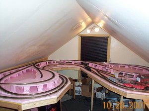

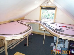

the grades are in place now, i am happy with one side but the other is much more steep......thats the one that will be hidden howerver......i don't think that i will be pulling much up that slope.....attacehed is a pic of the layout when it was under construction....also ad ideas on how to paint the rails after they are in place....i want the ones visiable to be painted rusty brown......i will paint only the sides that can be seen.....

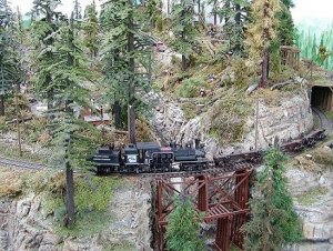

I weathered my track using artist acrylic paint. Two colours. Iron Oxide (actually made from rust) and burnt umber (made from burnt trees). I painted the ties/sleepers the burnt umber, and then used a mix of iron oxide and burnt umber to paint the rails. It didn't take long. The iron oxide is to intense to use by itself for rusty rails, so i toned it down a bit with the burnt umber. Then I put the ballast down (so not to get any paint on it). You can be pretty rough when painting the track, just wipe/clean it off the top of the rails later. But be very careful when doing the turnouts, so not to disrupt the electrical conductivity of the switch rails.

thanks for the info on painting the rails woodie, your track work looks great....and what a fine job on the landscape.....you did a real nice job there man.....i have read in a how-to book that you can spray paint the track brown then come back when that is dry and using a fine bursh paint the side of the rails rusty color......but i was wondering about paint on the rail....but all the post so far have said that i can remove the paint from the top of the rail as i paint before it drys.......

That grade on the left looks a little on the steep side, seeing as you have not yet started your scenery, can you start it before the curve about 18" back I would think. Otherwise, the track looks good.

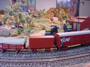

here is one of my grades, 3% on a curve.

yes that is the problem grade...it is very steep so today i started to do the landscaping to hide it.....i have made it like a canyon so it is not see and what is seen it has a limited view...the plaster hard shell is still damp as I type but as soon as it is firmed up i will post a pic of what it looks like after the results of topography....i was concerned with its steep grade but so far it looks good after the landscape.....:confused:
