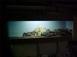

Here's my little N scale RR, that's still under construction.
Though it's not in my living room, it would fit easily enough. It's only 13" deep, & 60" long. It's sort of a box, with one side open, & a flourescent light inside.

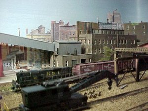

Here's a closer view of the right end of the layout. You can put a lot of N scale RR in a very small space.

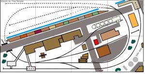

here's a 4' by 2' in N-scale, the trackplan isn't mine only I had to draw it up for John Farrel (UK N-gauger) as I photographed his layout for publication a couple of years ago.

That's a neat looking plan, Shamus!
Are the tracks in the upper left portion hidden?

My layout does have a top on it, & the inside height is about 18".
It's just two pieces of plywood, hung on shelf brackets, one above the other. The back & sides were made from masonite, & the bakdrop is an old piece of vinyl flooring, which bends around corners very easily.

Clem, the trackplan I posted in the other thread needs 5.25" of clearance, but with a simpler plan you could have as little as 2.5" cearance. with a simple over/under you could get by in as little as 4.25". The more complicated the plan the more room you need. even the plane I posted if stretched by as little as 8" could (From 62" to 70") fit into a 4.5" clearance.
I was costrained by the size of my dinning room and interest in uniformity of appearance.
