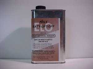

I use a product called Easy Lift Off (ELO)...It's a Polly S product.
It will remove decals, & paint, but it works slowly enough that you can remove as much or as little as you like. It will not damage the plastic.
What I do for removing the lettering is dip a Q-tip in the ELO, & blot it on a paper towel. (you dont want to use so much that it runs)
I scrub lightly with the Q-tip, & the lettering just goes away!
Then I take another Q-tip dipped in clean water, & clean off the area. Then dry with a clean rag.
The newly "undecorated" area may be slightly sticky, so let it dry overnight.
Then you can apply gloss coat, & let that dry another 24hrs.
Then apply new decals.
Then apply Dullcote, & weather to your liking.
Remember to keep your fingers off the area your working on until you're finished.
Hope this helps.
I'm including a picture of the 1 pint can that I've had for a couple of years. It's still nearly full...a little of this stuff goes a long way.
