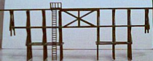

Well, I'll contribute my cent-and-a-half... My first scratchbuilding project was a small trestle that I intended to use on a future layout. Two layouts later and I still haven't used it. But my idea was to build the gorge roughly around the bridge, shortening the legs as needed. I figured it would be a give-and-take process. The hard part was that I'd have to shape the gorge so that the legs wouldn't need to be cut in the middle of the crossmembers...
Attached is a picture of the bridge. I figured that the legs on the end would have to be shorter, so I didn't extend them all the way down. It wasn't my intention that any except the middle two sets of legs would remain their present length.
-Rory

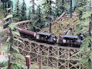

My method for trestle building is to first of all make the main support (1/8" ply) and lay track on it making sure that it is also removeable. Once you know the bridge part fits, make the rest of the trestle away from the railroad. When complete fit a cardboard frame to the underneath of the trestlebridge suitably painted and grassed, this will give you a starter on the scenery side as it is difficult to do later, and also show the steps in the trestle for adding the scenery later.
shamus
