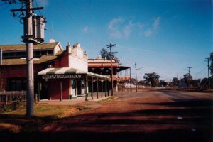

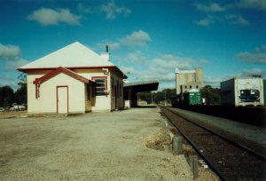

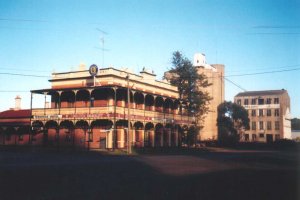

That flour mill and silo is in a place called Tocumwal on the Murray River at the Victoria/New South Wales border. These are some pics of the overall scene, and I'm leaning very heavily on using this town as a prototype for Garahbara MK II.
The Rotary Club in Tocumwal were donated a layout and they use it for fundraising from the tourist. $5 entry to have a look. Open "afternoons only" so the sign says. In here.

off the tracks here a bit Woodie ... but I have to tell you how nostalgic your pics made me (God, imagine a Kiwi being nostalgic for bloody Oz!!!)
But the pics reminded me so much of many of the places I saw in my journeys around Queensland and Northen NSW in my days of touring the states ( I was SUPPOSED to be working..)
Big sigh about the old Terminus hotel. Those pubs just used to blow me away. Gotta love that style.
Anyway mate, I look forward to the new layout.
