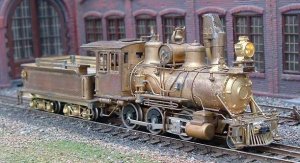

This one fills my sweet tooth for circa '70s brass nicely. It's an HOn3 model of the Colorado and Southern 2-6-0 Mogul #27. Micro-Train markets a model similar to it in Nn3, as far as I know, the only "mass" marketed model of its type. I just love the beartrap spark arrestor and the air tank on the boiler. There's only two other HO brass locos I want, a model of the Erie or Virginian 4-8-8-8-4 triplexes---especially the Overland 3 motor issue from the early 80s---and Mich-Cal's shay #2---the smallest shay built and it served all 61 years of its life with one engineer, Tom Jinkerson. At roughly $1800 total, it's not likely I'll be getting them either :thumb:
