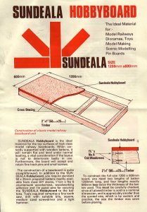

Here’s another alternative to chipboard/Plywood & Insulation, it’s Sundeala board,
and comes in 8' by 4' sheets. Comes in thickness of 1/4" and 1/2"
It is quite expensive, but well worth it in the end.
Makes making grades a lot easier.

Hi Bill,
Sundeala is another version of insulation board only has more density and flexibility, It is a compressed material, but I don’t know if it is available in the US under that name.
