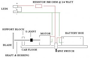

Hi Mike, that doesn't seem too hard. First of all I think you would have to fashion a shaft and bushing for the blades to turn on (a piece of brass tube and some steel piano wire) then simply couple that up(with a set of Athearn universal joints) to a cheap low rpm toy motor mounted on the inside floor of the plow. The switch could mount thru the floor and out of sight under the carbody. Use white LEDS for the lights...no heat and less battery drain. A motor that runs at 6 Volts would be ideal....thats 4 AA batteries in series. You'd have to put a 560ohm resistor in series with with the LEDS though as 6 volts will burn them out instantly. You don't want the blades to turn real fast so some kind of geared motor would be the thing....snowplows turn at less than a 100 rpms but they've got one heck of a lot of horsepower behind them. Just some random thoughts;) :D

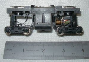

This is pure theory but worth thinking about....... to power (self propel) it the good mechanism from the HO Bachmann Spectrum 44 ton switcher runs good at 6 volts and I feel would be easy to fit. I've attached a pic of this loco's chassis in case you have never seen it's insides.
The plow blades could be driven from a model boat can-motor with an planetary motion in-line gearbox (not sure if these g/boxes are called epicyclic). I think these units are also inexpensive. If the blades motor is fed from a tiny bridge rectifier the blades would turn in the same direction irrespective of the direction of the unit.
Just my thoughts.
Errol

Sketch
Here's just a little sketch of my ideas on the snowplow that I sent to Mike. Thanks to Errol for converting this to the correct format:)

Yes, and thanks very much to Vic for putting together that diagram.
