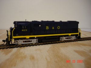

Guys I vote Paasche. I have never tried water based (yet). I like the results of petroleum based.
Randy...newbie to this forum
