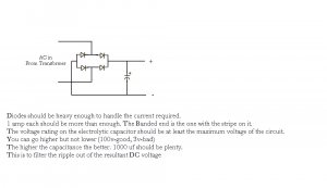

If my memory serves (quite often it doesn't anymore) what you need to convert AC to DC is called a bridge (?) rectifier, and you need four diodes to make one.
It isn't too complicated. If you have a Radio Shack nearby, they should have the parts and plans. (Ask the geek with pimples, not the manager!)
In answer to your question I put together this simple diagram. If I can figure out how to attach it I hope that it helps.

Radio Shack carries bridge rectifiers already made up -- square lump of plastic with 4 wires coming out but I don't know the ratings. They're usually rated in some totally useless combination of units, say, 200 milliamps at 600 Volts. I bought one but haven't found a use for it yet. At one point there were a number of firms that made rectifier units; I have a H&M one that I use for my Tortoise switch motors.
