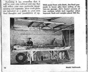

Floyd-
In the book "N Scale Model Railroading" by Robert Schleicher, he devotes about half of a small chapter on a friends layout that retracts into the ceiling of his garage. It includes pictures of the layout, bracing system and cables & pulleys. It is in N scale, but the layout itself is 7'x11' built out of wood. The next time your in a LHS, grab a copy and read through the section in the store. HTH.
Sorry, this scan wasn't too good. Hope you can get the idea.........
